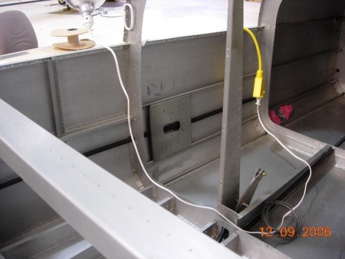

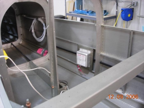

Installed the brackets for the Strobe PS and the ELT today. Pretty simple installs. I used the new Van's kits for these and I cut alot of time out of mounting them.
I didn't like how close the rudder cables came to the brackets, though. So, I installed some 0.51" corrugated conduit for the cable to pass through.
Future home of the ELT
Strobe power supply
Strobe power supply
