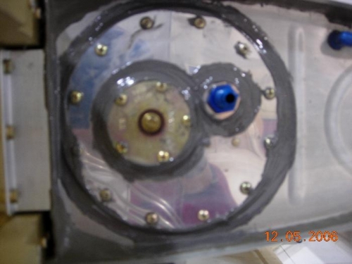

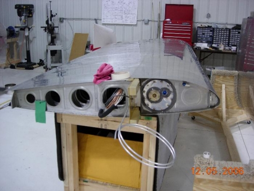

Brief Description:  Installed Fuel Tank Cover Plates
Messy. Installed the left and right fuel tank access covers and the fuel sender units.
Re-tested the sender units with a multimeter. I just used the wing spar for ground and checked them at the terminal on the sender unit. They read correctly--pretty cool that I could use the spar. I thought that I might have to attach a pigtail at the cover plate since the screws are prosealed into place, but there was plenty of metal to metal contact.
