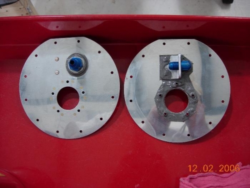

Fabricated the fuel line anti-rotation brackets.
Once those were done and match-drilled to the cover, I prepped the inside cover for pro-sealing. I masked off the area around the fuel sender nutplates and the area under the bracket. I installed the bracket and the fuel line into the cover plates. Set it all aside to cure.
Later the fuel line and the senders...
Outside and Inside Views

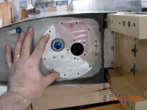

Right Cover Location
