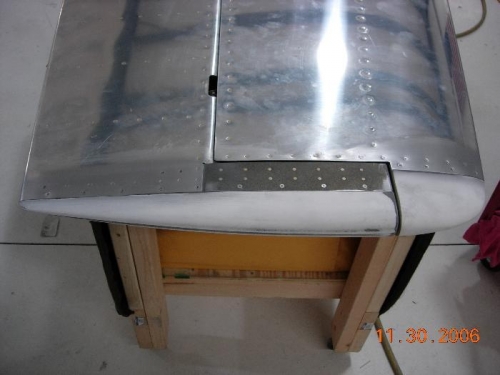

This took a few days with stopping for epoxy curing over night each evening, but not much shop time.

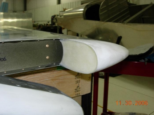

I installed polyisocyanurate foam in the aft ends of the HS tip fairings to give me a way to contour the shape to follow the swing of the elevator counterweight. I sanded it using the counterweight as a sanding block with the sandpaper built up to the gap I wanted to create (pic 1). I then laid-up two layers of 9oz e-glass for strength (pic 2).

Foam shaped
Foam shaped
End glassed
End glassed
