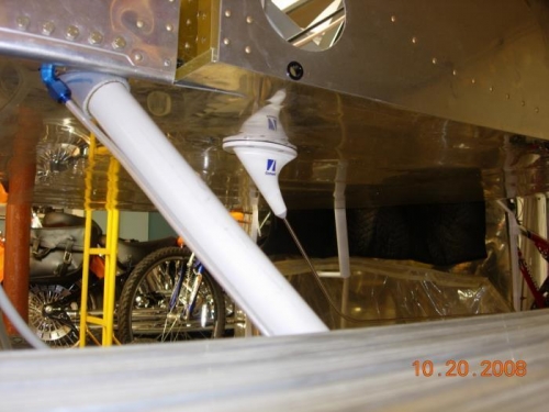

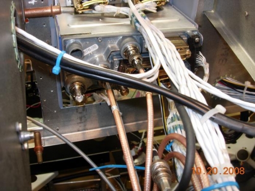

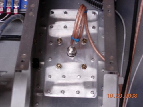

Installed the VHF communications antenna today. Routed RG400 wire from the radio rack into the center fuselage. Fabricated a doubler to mount the antenna and bolted it onto the bottom of the fuselage.
radio attach point
fastened and wired up
bottom view
