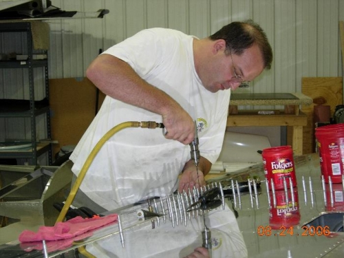

Left Flap Installation
Aligned left flap per plans to left aileron. (Used angle aluminum to keep alignment with clamps and duct tape).
Match drilled flap hinge to wing skin. Deburred and dimpled hinge.
Installed left flap brace to rear spar, installed brace and hinge to bottom skin.
Dry fit flap to wing. (Need to drill hole for hinge pin into aileron brace, shorten pin and drill safety wire holes in loops).
Picture for FAA
