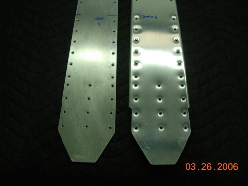

Brief Description:  VS Dimpling
Finished deburring VS parts after match drilling. Setup DRDT-2 dimple die press and dimpled the ribs, spars and skin. What a great tool---I'm so glad I got it. Quiet and simple one-handed operation.
After some clarification of the plans, clecoed everything back together to locate and drill the bottom corner holes of the bottom VS-411PP hinge bracket. Instructions called for them to be drilled in assembly with the fuselage, but that only applies to the taildragger.
Corner holes for HS411 done
