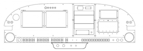

Brief Description:  Instrument Panel Design
Spent the whole month working on my instrument panel. I'm just making on entry in the log since what matters is the final design (but I may add more pages later to show the iterations).
I decided upon installing the following avionics equipment:
Grand Rapids Horizon HX EFIS (dual display)
Grand Rapids Dual AHRS
Grand Rapids EIS
PS Engineering 8000B Audio Panel
Garmin GNS-430W WAAS GPS/Nav/Comm
Garmin GTX-327 Transponder
NavWorx ADS-B 600 Transceiver
TruTrak VSGV Autopilot
I chose the Horizon for quality, features, and helpfulness of the staff during selection. Plus, many features that really are great especially that I can control the autopilot from the EFIS.
final instrument panel layout
