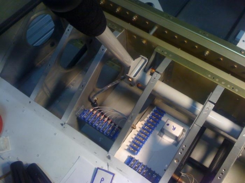

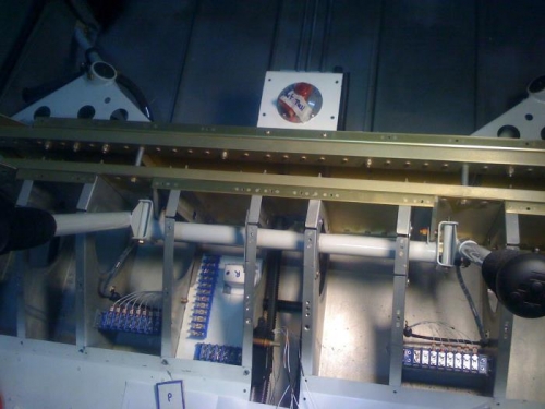

Installed the copilot's stick after drilling the wire passthrough, installing the snap bushing, and prosealing it into place.
Next, I modeled a deck from posterboard to mount the trim servo relay and the terminal blocks for the trim system and stick grip buttons. I tried several locations for the deck. This is proving to be a challege--not interfering with the flight controls and finding a place that made future maintenance reasonably easy.
