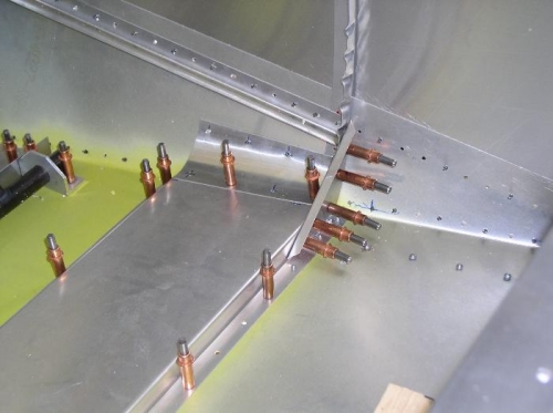

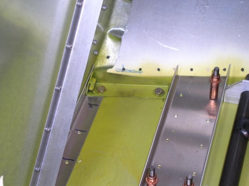

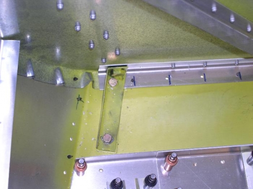

Brief Description:  Cabin side to floor
Cut the lower forward side skin to fit to the cabin floor. Installed the gussets inside the cabin, from the side skins to the kick plate. The upper and lower engine mounts where drilled and installed. Also did some of the riveting of the cabin floor.
