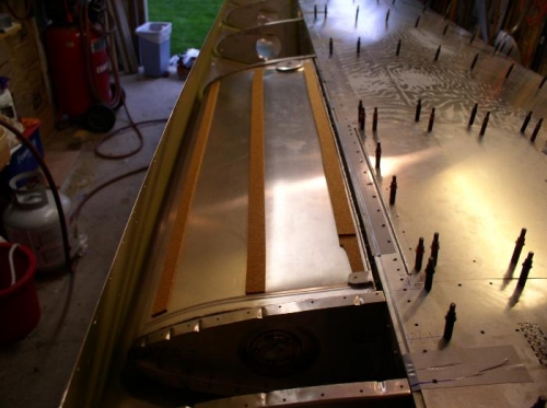

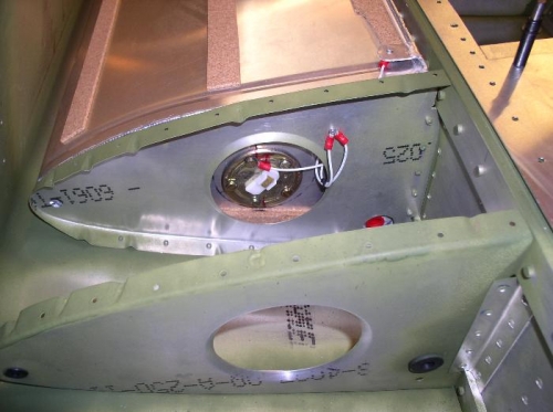

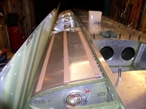

RH Fuel Tank Installed
The leading edge of the RH wing was opened up and the fuel tank was installed. The drain and vent holes were drilled, and the fuel fill hole was cut. The sender and tank were grounded to the nose rib.
