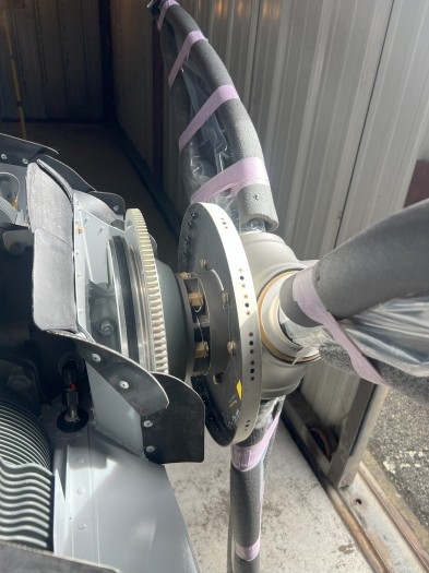

Brief Description:  Installing Propeller and other various components
Installed propeller torquing to 55 ft/lbs. Safety wired propeller and spinner bolts. Installed seat belt tabs, spun engine to get pil pressure and then installed spark plugs. Installed canopy breaker.
