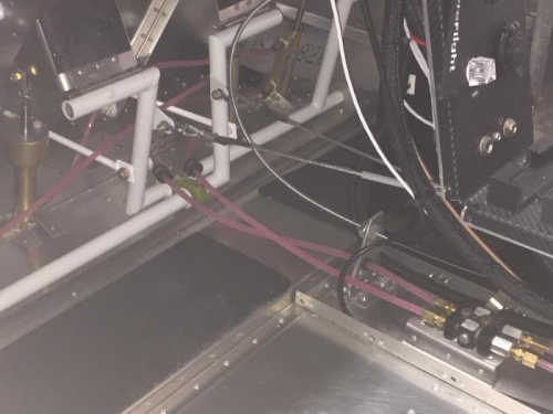

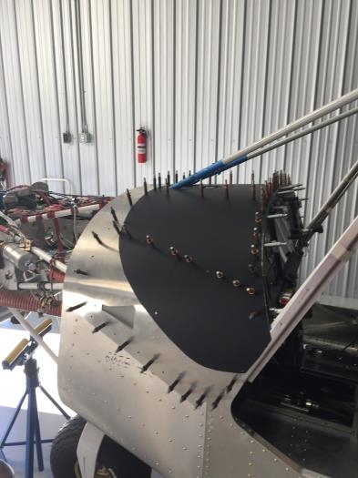

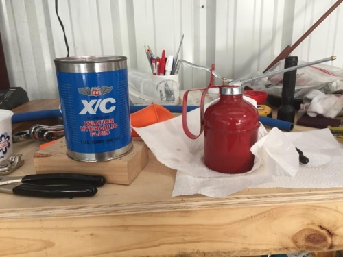

We finally took a stab at bleeding the brakes. Overall, it went pretty well but we had a couple of instances of leaky lines and pesky bubbles. We pumped brake fluid from the brake nipple to the brake resevoir through the parking brake. We eventually got the air bubbles out and had solid brake feel. The parking brake worked well too. Next, we reinstalled the top skin and clecoed in the supports. I filed down the L angles that were conflicting with the intercom and that no longer inhibits the instrumetn panel. All told a good productive day.
Brake fluid and pump
Brake fluid in the lines
Top skin in place
Top skin in place
