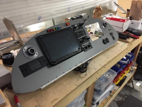

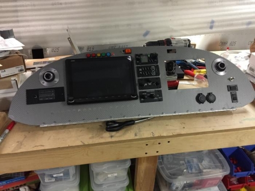

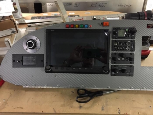

Brief Description:  Installed avionics on panel
Finished installing the Skyview HDX, sub panels, warning lights, eyeball vents, USB's, EXBus annunciaor panel, Ray Allen trim switches, flap switch and fuel low level light. Tightened the screws and then primed and painted the map box door. Drilled holes for the 1" ball that will hold the ipad. Only the USB for the Skyview, ELT panel, and switches remain. We are fabricating fittings for these as the holes on the panel are too big. I have to say, I really like this panel and avionics. Will install the map box tomorrow.
