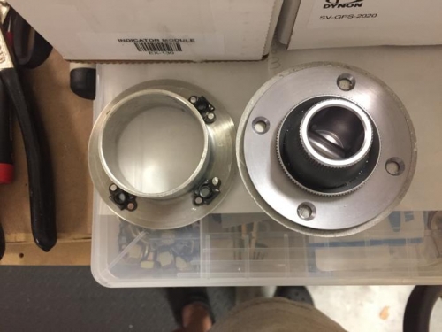

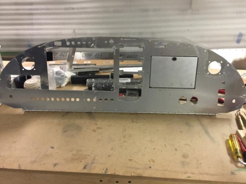

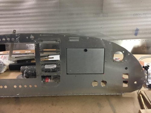

Brief Description:  Still working on instrument panel
Finished installing nut plates for sub panels and annunciator panel. Drilled and added nut plates to the flange that connects to the eyeball vents. Drilled #40 holes in the glove box and then drilled the holes in the instrument panel. Added nut plates for #8 screws.
