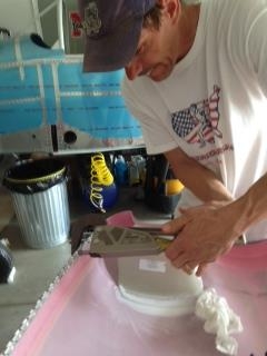

Installing the Hinges
Riveted the piano hinges to the cowl. I also mixed up some epoxy to supplement the bonding. This was optional and recommended by Van's. Vibration could loosen the rivets in the fiberglass over time.
