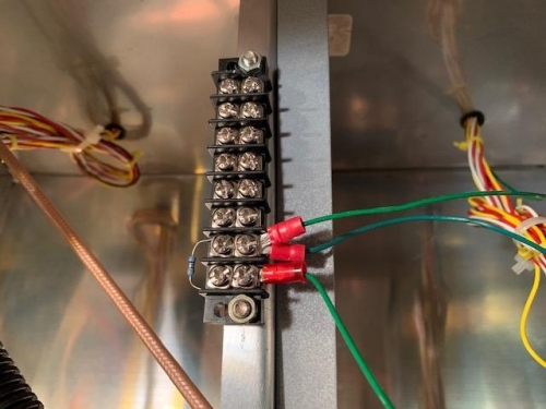

EIS tach wiring
Wired up the tach. One wire to the left mag and one wire to the right with a 27k resistor. They join up to a terminal block behind the instrument panel. A switch wasn't needed. The EIS will switch automatically when doing a mag test.
