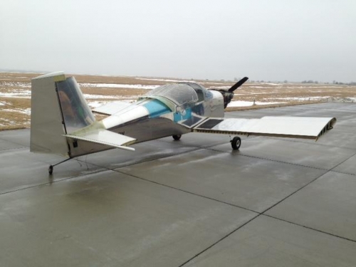

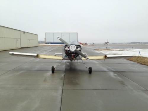

Wings are on for good! The wings are held on by close tolerance bolts meaning they fit very tight! Putting the bolts on dry ice beforehand and lubing the shank with some LPS #2 oil worked for me. Also, light taps with the rivet gun and they went in nicely.
Wings are on, less the fuel tanks.
Looks like she's ready to fly!  Now on to the flaps.
