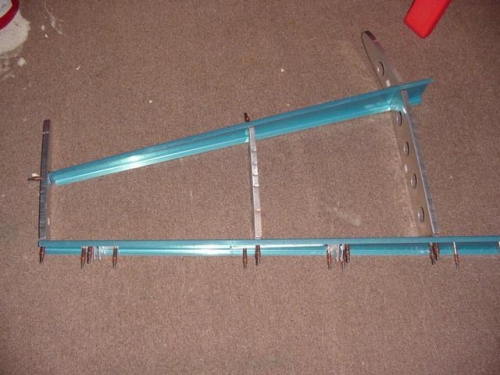

Brief Description:  Drilling the Vertical Stabilizer
Fluted and straightened the VS-704, VS-705, VS-706 and VS-707 ribs. Final drilled #30 the VS-808PP, VS-410PP, VS-411PP and VS-412PP to VS-803PP pieces. Also final drilled #30 the rib to spar attach points.
