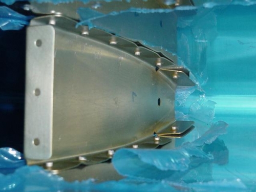

Brief Description:  Riveting the Horizontal Stabilizer

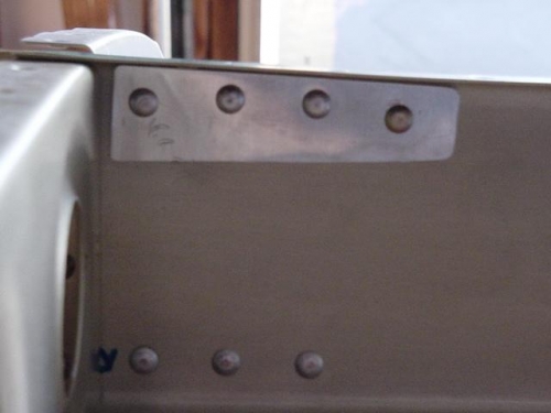

In the process of drilling out a bad rivet, I enlarged the hole. Van's advised me to fix the problem by building a strap out of aluminum (.063). I made the strap and riveted it into place (picture 1). I also riveted the HS-707 into place (picture 2).
