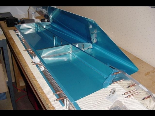

Date:  1-10-2004
Number of Hours:  1.50
Manual Reference:  Sec 6-2
Brief Description:  Drilling the Horizontal Stabilizer
