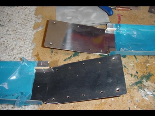

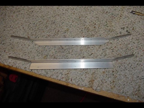

I bent the outboard ends of the HS-710 and HS-714 spars to a 6 degree angle. I also trimmed the flange of the HS-702 spar and bent them to a 6 degree angle also.
