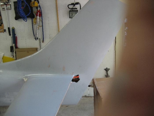

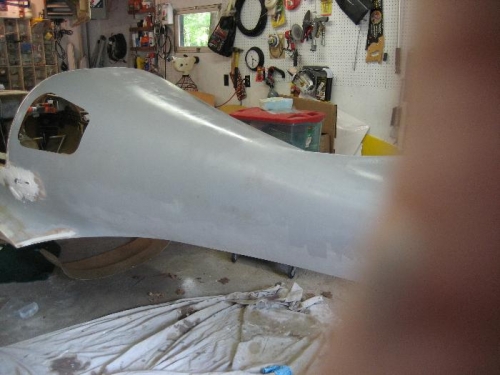

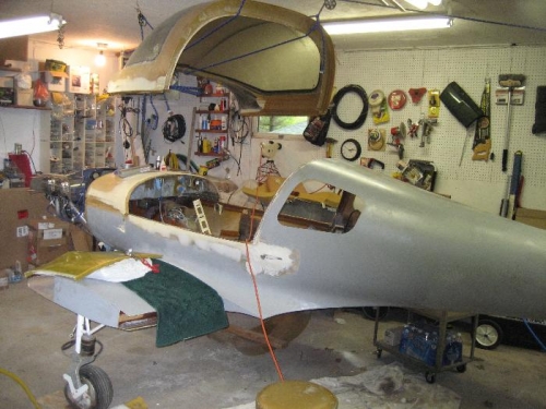

Brief Description:  primer
Sanded stub wings, top of fuse, flaps, ailerons, vert stab and rudder and applied first coat of WLS Epoxy primer with brush and squeege per Lancair recommendation to fill weave. Stub wings fuse already had one thin coat WLS primer. The underside of fuse has been in primer and finish sanded to 400 grit.
