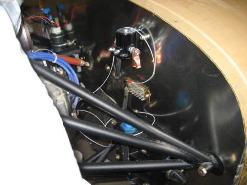

Date:  6-30-2009
Number of Hours:  5.00
Brief Description:  GROUND WIRE
Installed "Forest of Tabs" from B&C Specialty per their instructions and ran #2 cable from firewall side of "forrest" to starter ground. Also ran #2 welding cable from future battery location to "FoT"on aft side of firewall.
Decided on adding high & low hydr gauges by inserting "T's" in lines at dump valve.
"forrest of tabs" (under solenoid)
