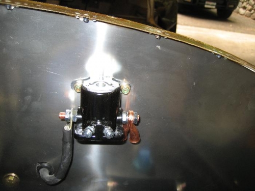

Brief Description:  pos wire, faired rudder lite, other.
Cut off AMP connector, run wire thru grommet. (used shrink wrap, wheel bearing grease to feed line thru grommet. Then cut off end back to grease free area, Crimped and soldered new AMP connector using dull bolt cutters. Installed line on starter solenoid. Left extra 2 ga wire behing aft baggage bulkhead.
Faired rudder fairing for tail lite with micro, then covered seam with 1 ply 3/4 oz model airplane fiberglass.
Used rest of micro to fair in joggle on fuselage for canopy. Also TE of left stub wing.
Applied flox to two bolts for starter solenoid, and covered with 1 bid on aft firewall.
Also floxed and glassed plywood cutout on left from moving cabin heat valve.
