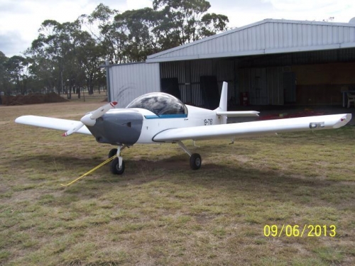

Date:  6-9-2013
Number of Hours:  6.00
Brief Description:  Finishing jobs-Complete.
Tied down aircraft outside and test run engine. Full revs only gave 2600rpm so repitched prop and got 2900rpm static. Will leave at that for test flying initially. Taxi tested around the airstrip, bedded in brake linings and generrally got used to taxi-ing around. Engine idle needs adjusting higher, as engine will quit if pulled back to idle. Construction of aircraft essentially complete now, only minor tweaking of systems and test flying to go.
Bye Bye building log.........
