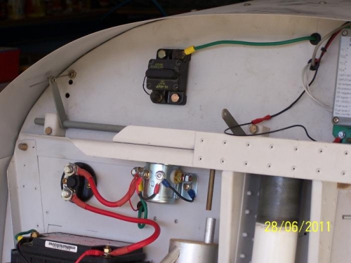

Date:  6-11-2011
Number of Hours:  4.00
Brief Description:  Main wiring
Fitted and wired up main isolater and starter solenoid using #4 wire. Fitted 30 amp circuit breaker and wired through to a 50mva current shunt direct to the EXPbus. Main #8 wire runs back to the battery, connected to the starter solenoid, in series after the main isolater. Main isolater has a removable key reachable on passenger side on cabin side of firewall.
