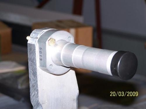

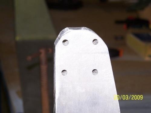

Fitting axles to spring gear. Very strong piece of aluminium! Weighs 21 Kilos and is 3/4 thick. Had to stand gear up and use my drill press to drill holes after marking with a transfer punch( Thanks to my son Mitchell). Fortunately came out spot on this side. Shaping square edge to axle curvature, and will need a notch cut out for brake calipher mounting bracket.
axle mount holes drilled to 1/4
Axle fits perfectly, shaping curve with a file.
