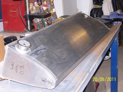

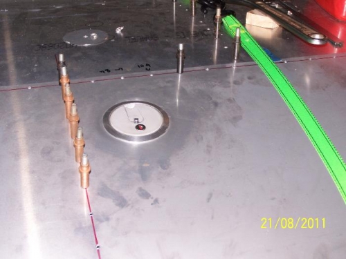

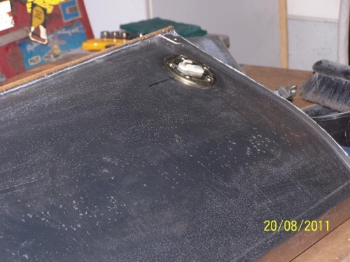

Brief Description:  RH Fuel tank
Fitted sender unit to top of tank instead of down the side. Glued cork strips to outside of tank and fitted in the nose skin between nose ribs. Located fuel filler hole and cut out of skin and fitted filler. I had to add a packer between the tank and skin to get a good fit
