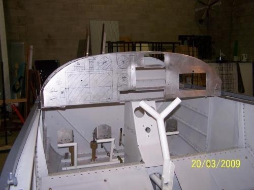

Brief Description:  Longeron doublers
Completed L/H side longeron doubler and starting to fit canopy rail. Lined up latch with lock bolt on rail and made cut out in longeron and doubler, hoping for a good fit. No clear plans available to retro fit new 650 canopy latch, so just winging it as I go. If I get the left right will carry on with the right.
