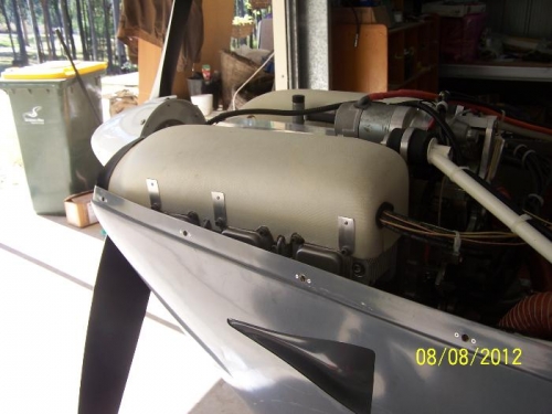

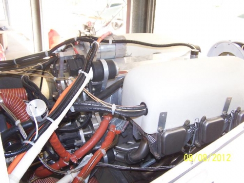

Brief Description:  Completed engine ram ducts
Made up reinforcing tabs for the ram air ducts at the attach points, epoxied blank off sections in the inlets and glued rubber flanges to front of ducts and installed ducts for final time. Finished all scat hose connections and double checked all wiring.
