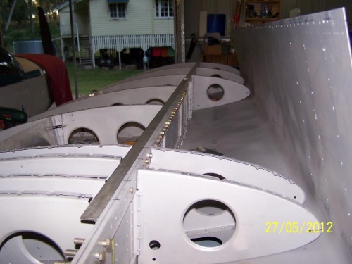

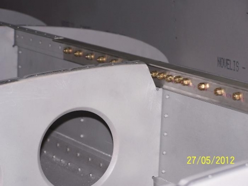

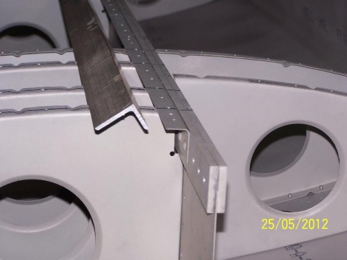

Main spar angle
Cut out spar angle 6W3-6 at 1680mm and replace with 6-ZU-1-1, much stronger 1/8 inch angle. Drill out all solid rivets and replace with AN3-10A bolts and lock nuts. Torque to 22 inch pounds.
