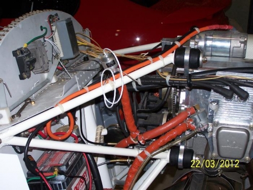

Date:  3-22-2012
Number of Hours:  4.00
Brief Description:  Fuel system etc.

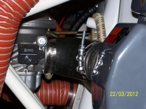

Completed FWF fuel system. Teed in a UMA 6psi fuel pressure sender between engine mechanical fuel pump and carby. Re-routed hose from gascolater to fuel pump away from exhaust scat hose. Fitted elbow between carby and air box. Made up earth strap from engine to battery
