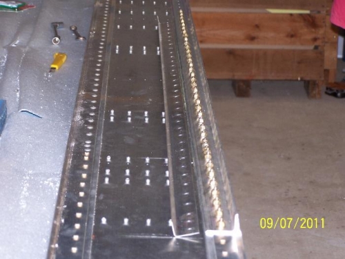

Upgraded right wing spar.
Removed all rivets and replaced 1680mm of 6W3-6 with 6ZU-1-1 angle which is 1/8 thick. Much stronger. Bolted together with AN3 bolts. Also fitted 6ZU-1-2 wing root doubler then removed so as to fit rear ribs first.
