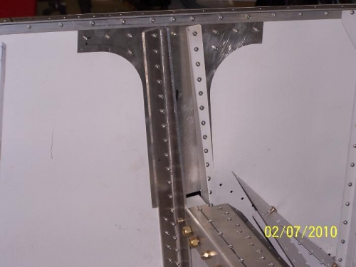

Installed right hand wing upright into place, marked wing mounting bolt with a hole punch, drilled close to size then reamed to 5/16 final size. Refitted and riveted to frame.
R/H wing upright riveted in

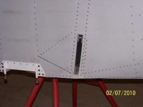

Ext view, R/H wing upright rivet detail
