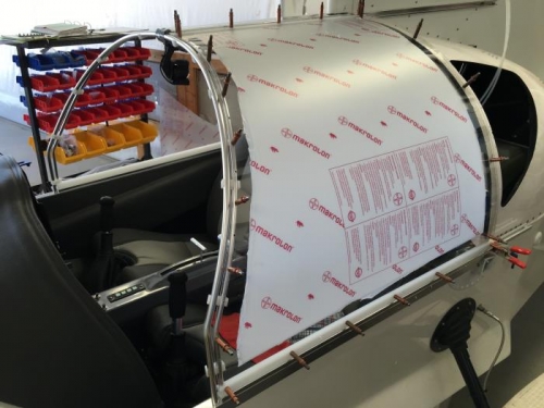

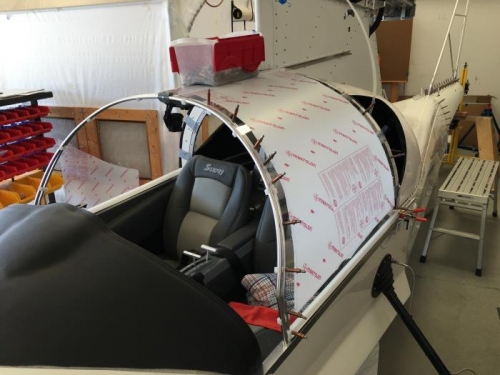

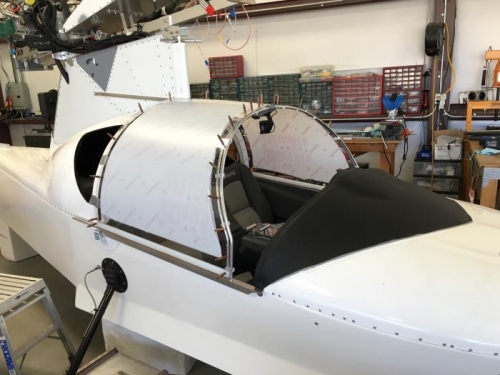

More work on the canopy windows.
Jim Ratte's method to fit/match the canopy to the windshield, utilizes a set of cool little snap-in blocks that I fabricated from some nylon stock. These are used to lock-in the fit between the windshield bow, and the fwd canopy supports, about five per side.
You can see them in place in the photos,
