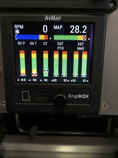

This is how the Temps are supposed to look

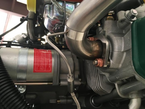

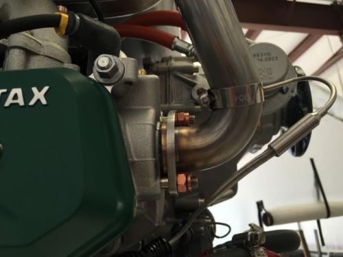

Example of one of the new,
Example of one of the new, "ungrounded" probes
