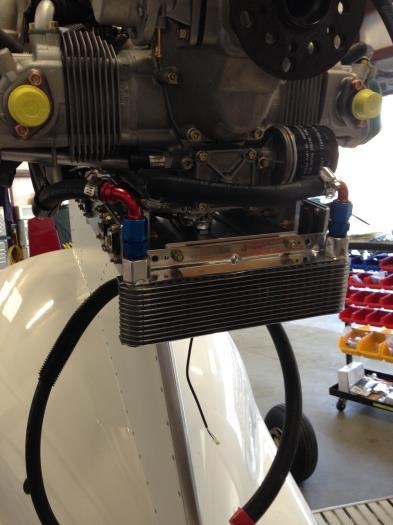

Mounted the Oil Cooler today.

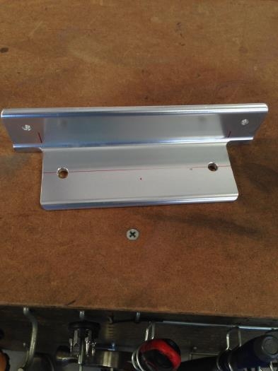

The supplied mount angle will not fit between the engine mount angles, and still provide for a required edge distance for the holes. I just could not see anyway to get the stock angle to fit, securely.
So, I decided to modify the Oil Cooler Mount Angle, to fit in between the two engne mont angles.
Modified Oil Cooler Mount
