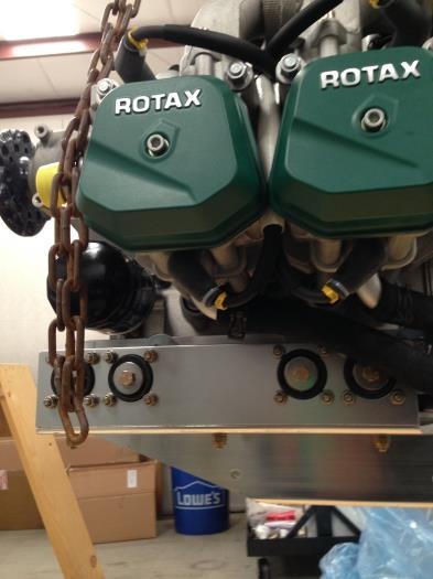

Brief Description:  Rotax 912 Engine Prep & Mount
Continued with the engine preparation.

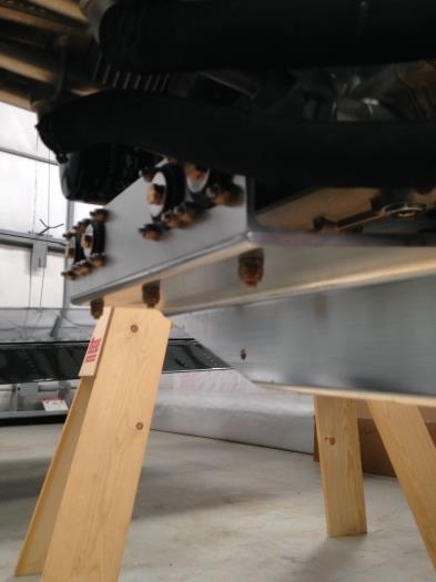

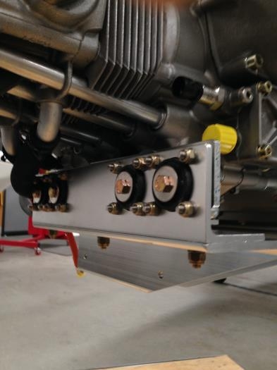

Built up and installed the engine mount angles and Lord Mounts.
Ran into an issue with the mounts, they seem to interfere and chaff the lower coolant hoses on either side of the engine.
I will order some hose stock and replace those hoses with slightly longer ones, to allow for a little room for movement.
