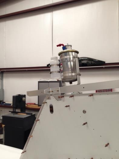

Worked on the Oil Tank & Coolant Recovery Bottle installation.
Attempted to install the Radiator Mount Angles, but ran into an issue. Called out bolts (AN4-23A) are too short, require AN4-26As, which I do not have in stock.
Also started with the Rotax 912 Engine Prep:
- Swapped positions of the Oil Plug and Oil Return Line
- Reoriented the Water Pump Inlet casting
- Saftied the gearbox Chip Detector
- Reversed the Trottle return springs
- Removed & Replaced the Throttle Brackets
- Rerouted the Fuel Supply line
Drilling the Oil Tank mount
Oil Tank & Coolant Bottle mounted
