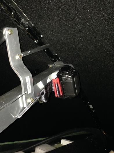

Also looked ahead and installed the two inertia reels (Section 24)
Had to drill out the main mount holes on each of the two reels,, as the factory hole was about 1/8" undersize to accept the radius of the two AN4 washers.

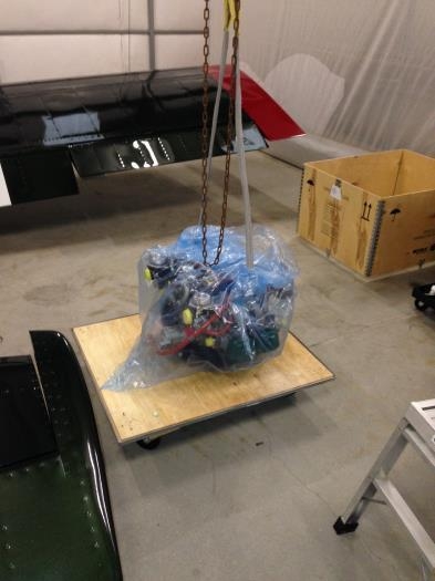

Broke the engine out if it's box today, to get set for the prep work.
Early on, I purchased the Rotax Carb-Heat modificattion kit. After careful consultation with various other Rotax users, I decided to "shelf" theCarb-heat kit, for now.
(Add to that, I really don't like the idea of teeing into coolant lines, any more than absolutely necessary).

"Un-Boxing" the Engine!
Pilot's Inertia Reel
