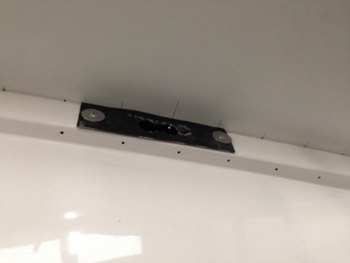

Still making progress with the pylon skins:

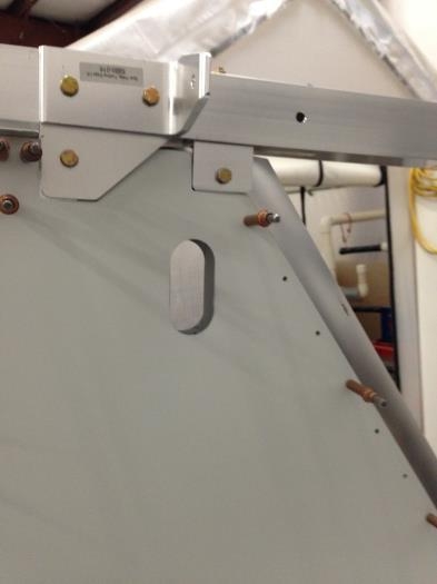

- Finished the fit & trim of the RH side
- Finished the Heater Hose cut-outs for both sides

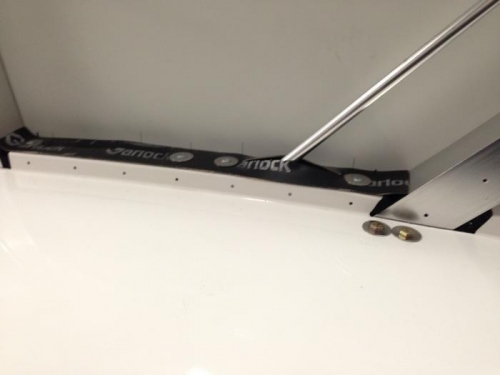

- Installed a very basic form of weather seal along the top of the Turtledeck cut-outs. Not sure this will work, and it definitely is NOT water-PROOF,, but I'm hoping for a tad water "resistant",,??!!
- Next I have to fit & drill the front pylon cover, then await parts to fabricate the Pylon Inspection Cover access on the right.
