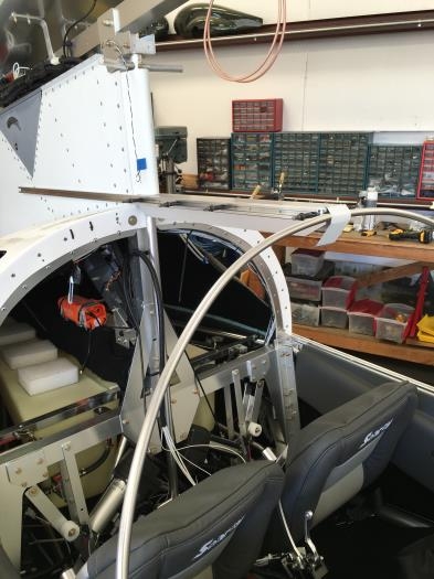

Started something new: WindshieldSupport & Choke Plate.
Worked on the initial fit, decided to use machine screws to mount the upper canopy rails to the support because I wanted to be able to remove them before I paint the Pylon.
Yes, the rails are riveted to the pylon, two places per side,, really no way around that, but I can just use clecos until the final rivets are installed and still have the ability to work on the canopy
