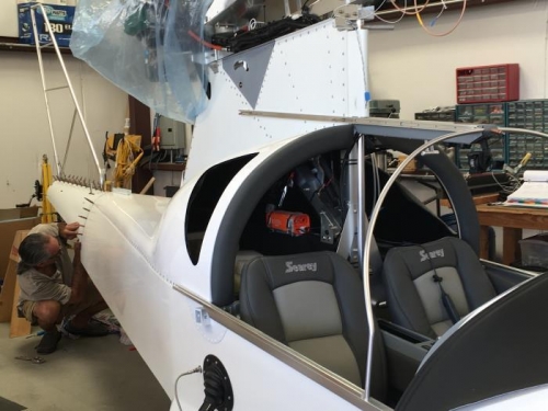

Date:  8-5-2016
Number of Hours:  1.00
Brief Description:  MLG Check-Out
Jacked the airframe to conduct a full, operational check of the MLG using the actual cockpit controls.
Up until this point, all of my MLG actuator checks were accomplished by applying 12VDC, directly to the actuators,, mainly to check for freedom of movement and micro-switch placement.
Today, was a full-sytem check, including the position lights.
