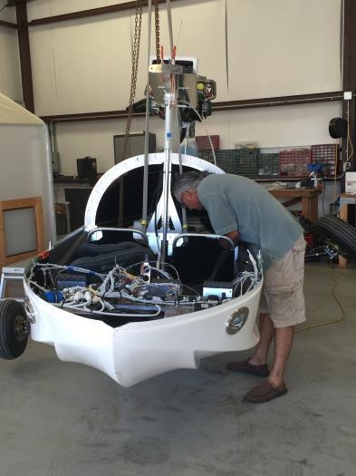

More cleaning-up of the wiring,,
Terminating ends, assembling connectors, and supporting the wire-runs

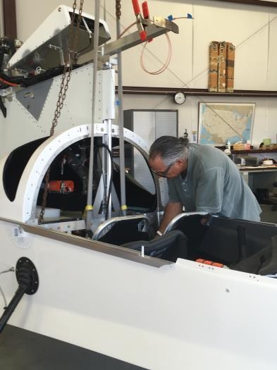

Hoisted the airframe off the ground so I could run the actuators through, once again, to verify that the up & down MLG icro-switches were correctly placed. Good thing I checked, had to reposition two of them!
