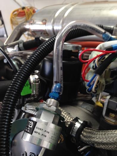

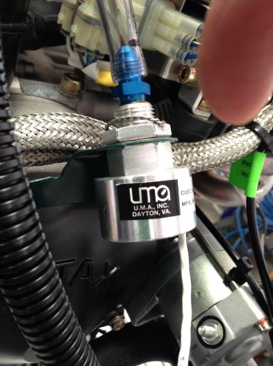

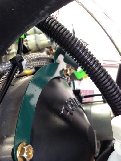

Had to come up with a method to mount the somewhat bulky Fuel Pressure Transducer.
I didn't want to attach it directly to the Rotax fuel manifold, and frankly, I doubt there is enough room.
Mounting on the root tube would have required a very long hose, seems somewhat of an overkill for just a transducer.
So I came up with an idea and fabricated a simple bracket that mounts to the fwd end of the engine. This will require a relatively shoprt, 6" length of hose which is on order. It will be Stratoflex 101, with integrated firesleeve
The clear hose in the photos is only temporary, used as a means to measure the length of hose required
This shot shows the the bracket, as mounted on the engine
Clear hose is only temporary,, just a simple method to accurately measure the length of hose required
