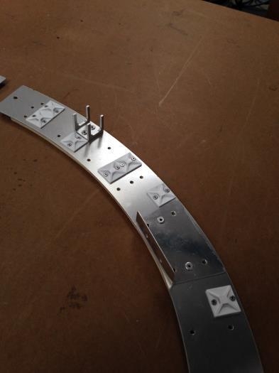

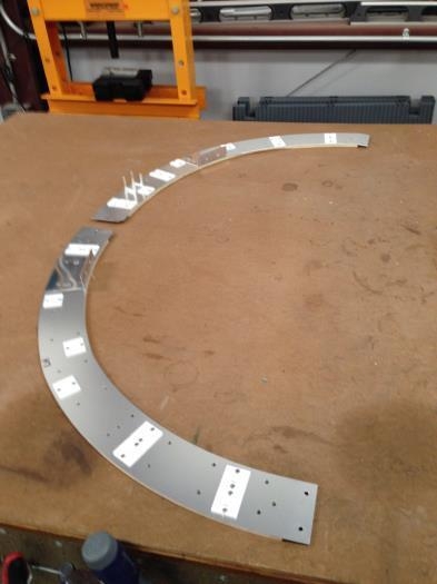

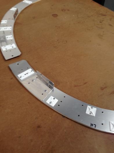

Brief Description:  TurtleDeck Bulkheads
Built-up the two TurtleDeck Bulkheads. I had to fabricate mount brackets for each of the two Fuel Flow Transducers (FlowScan: "Red Cubes"), to mount on the aft face of each bulkhead.
I need two, to compensate for the fuel return line.
(Later decided agaist these, just made for a complicated installation and opportunity for leaks)
This gives a clearer piture of the Fuel Flow Transducer mounts
