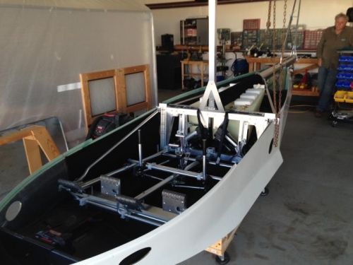

It's here! The "big" day,,
This is where I drop the fuselage frame, into the hull!

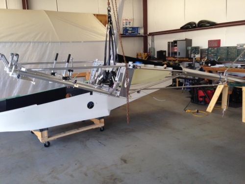

Used a chain hoist attached to the center of the hangar, and with the help of some assistants, the process went very well and surprisingly easy.

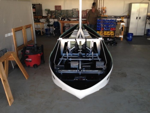

I did notice that the frame, doesn't sit exactly square rto the hull, up in the front. But all of the major attachment points: boom-tube * cross-tube cutouts, asre squared & equal.
Recall that my hull came pre-drilled, so unless I wanted to embark on some major modifications and re-glassing, I had to work with what I had,, and to be fair, after checking all of the cutouts, they were exactly where they were supposed to be.
So perhaps the hull isn't exactly square (which, considering the size and how it's constructed, I guess is entirely possible)
Anyway, I don't see where this will adversely effect anything down the road, so I will press-on!
