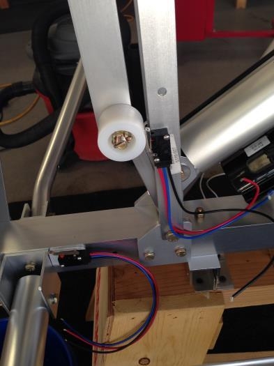

Brief Description:  MLG Micro-Switches
I decided to not use the PA supplied Micro-Switches, and opted for the "waterproof", sealed versions offered by Recreational Mobility.
Took me longer than anticipated to install these, mainly due to a "slight" builder error.
I missed-drilled a set of mounting holes for one of the switches and had to fabricate a mounting pad.
Also:
The LSA manual installation directions differ from reality. The mounting holes & screws provided with the switches (from both PA & Recreational Mobility), are 4-40.
The manual has instructions for drilling & tapping for 6-32.
In addition, the hole pattern differs between the manual and the actual switches.
So a word of caution here for any new builders,,
Use the switches as a template for the holes!!
