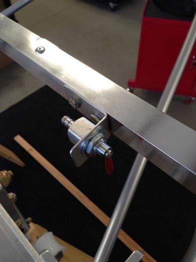

Section 4.3:
Fuel Sump Shut-Off Valve install.
Not sure what PA was thinking here, but the AN3-5A bolts are WAY too long for this bracket & angle combo. Had to use AN3-3As instead.

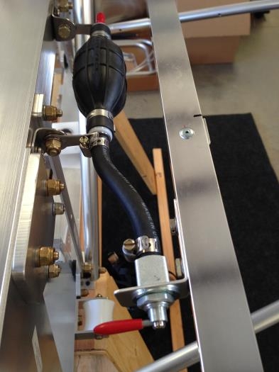

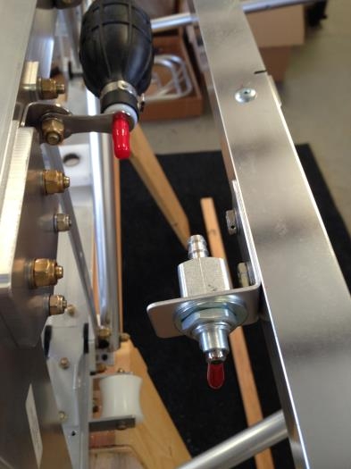

Section 5.4:
Decided to plumb the hose between the Primer Bulb & Sump Shut-Off Valve.
Another parts shortage, no 1/4" hose clamps included in the kit or even on the inventory. This puzzles, me, because the larger sizes are provided,, and they provide the 1/4" hose, so it would be rational to assume that the smaller hose clamps would be provided as well.
Oh well,
Had to raid my private stockk, again!
